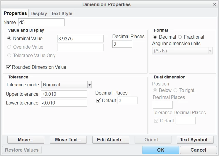

I'm coming from Wildfire 4, so I guess I may have zoned out on previous discussions about this issue.
I've played around a bit in Creo 2, I'm not sure I would call what I'm seeing an enhancement. We work on some highly accurate parts, it not uncommon to use 4 digits in inches and 3 digits in millimeters.
I entered 3.9375 in the sketcher. The sketcher shows 3.938. Finish the feature and measure, it shows 3.9375. Double click on the feature to show the dimension and it shows 3.938. double click on the number to edit it and it shows 3.9375. The drawing shows 3.938. Edit properties on the dimension and it shows this.
[cid:image002.png@01CDB6A5.678682A0]
This is different behavior than in Wildfire 4.
What config options control this behavior?
* What settings make it like I see out of the box in Creo 2
* What settings restore it to traditional ProE behavior?
Why would I want the new behavior?

October 30, 2012
It looks like it is doing what you are telling it to do.
Nominal value 3.9375 when displayed to 3 decimal places is 9.378.
What are you expecting to see?

October 31, 2012
It's rounding the value but not changing the nominal. This is a change
from long standing behavior in Pro/E. In the past, changing the number
of decimal places of a dimension actually changed the value. As a
comparison:
Past behavior:
Entered value - .28125
Rounded value - .3
Measured value - .3
New behavior:
Rounded value - .3
Measured value - .28125
The idea in the past was that if are saying that you can allow the part
to be made at 0.3 +/- 0.1 (the likely tolerance on a 1 place dim), that
gives a different acceptable range (0.2-0.4) compared to a nominal value
of .28125 +/- 0.1 (0.18125 - 0.38125) and the model should reflect that.
Over the years, many wanted to simply round the display leaving the
nominal alone and didn't understand why their models were changing
simply by rounding dimensions. The default behavior was flipped,
starting I think in WF5.

October 31, 2012
Based on my experience, there are many cases from a tool manufacturing standpoint, where the rounding is beneficial when used with a tolerance block. For example, screw clearances are often fractional size drilled holes that can have a value of 3 or more decimal places. To keep the print clear these hole sizes are shown with 2 places to match the appropriate block tolerance, but the model should still reflect the fractional size hole so the machinist/programmer can easily select the correct tool. The print is then easy to scan for critical (usually toleranced dims) and non-critical (usually 1 or 2 place non-toleranced dims) features. If the print shows a 4 place dimension and a wide open tolerance, it is confusing and requires more time to interogate. And if the model shows a non-standard, 2 place, hole size, the cost could increase because the hole might be made with a more expensive process than needed (ie machined instead of drilled).
PTC gives you both options with checkbox and the default choice can be set with your config.pro per David's post:
