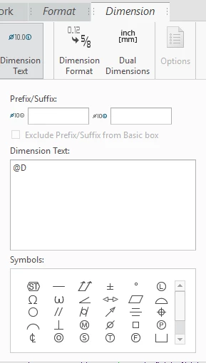

Can anyone help me identify the path to the file containing the symbols for dimensioning?
I recently got a new pc and therefor reinstalled Creo4.0 M030.
On my old pc the symbol palette looked like this:
OldOld
On the new pc it looks like this:
NewNew
As you can see I now have other symbols in the palette but also especially the diameter symbol "Ø" is significantly different and it stays different when I print the drawing as a PDF.
I have searched through config.pro and other .pro and .dtl files but I cannot find the location of these symbols.

I think earlier you were using drawing option symbol_font as legacy in drawings and in new it is asme.
If you will change the symbol_font drawing option in drawing to legacy, you will get old symbols.

I can find the symbol_iso.ttf and symbol_asme.ttf (font file) in my Creo directory but where do I make Creo use one or the other?
March 27, 2019
In your *.dtl file:
default_annotation_font <font_name>
