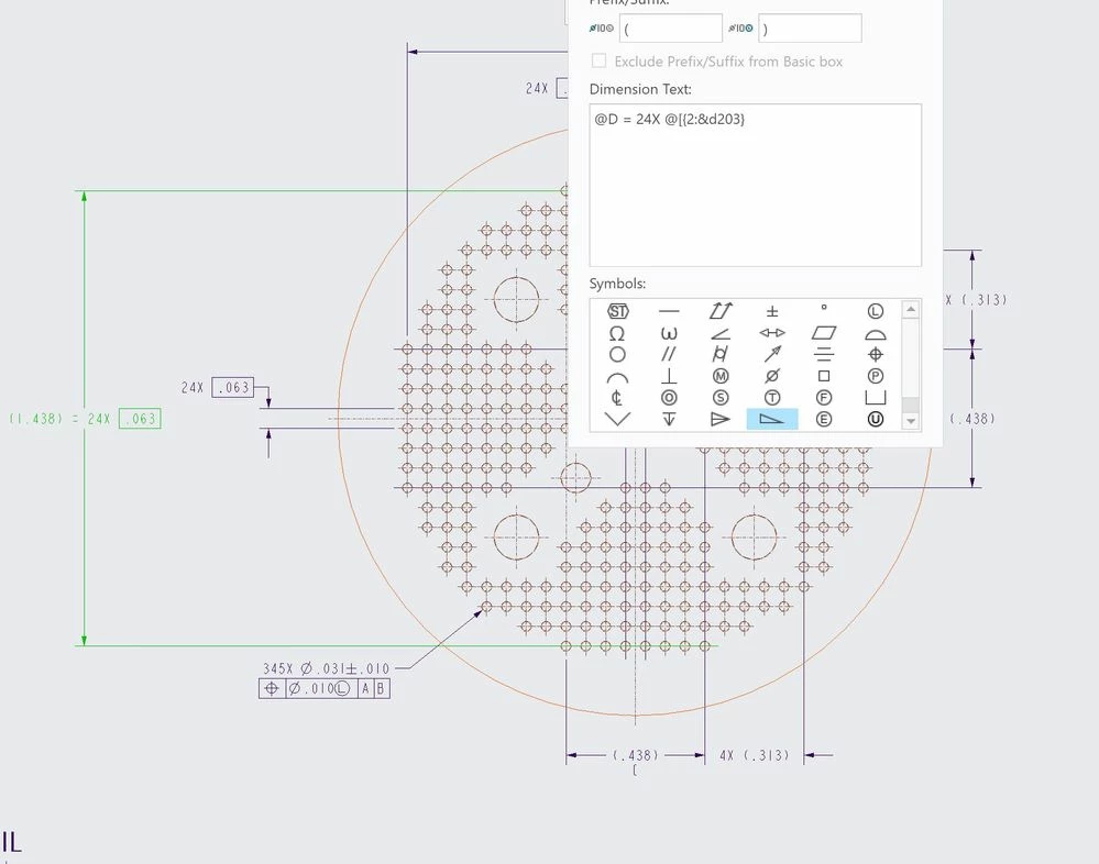

Dimension Text Modifications
 Dim Text Mods.JPGI am modifying dimension text in Creo 8. Is there a comprehensive list of text modifiers, such as @O for override or  @[{&D203} to display dimension 203 as basic when being referenced inside another dimensions dimension text?
