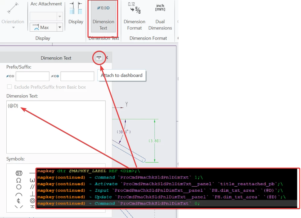

Here is a combined screenshot of the culprit window, as well as the mapkey that is being used to cause this routine crash.
The functionality is now such that when you call the Dimension Text Pop-Out, it forces it to disconnect. This exact same mapkey used to simply display the window, then close it (CREO 5). Now it causes the window to Pop-out, and locate somewhere random on the screen.
The crash seems to be caused not exclusively by the mapkey, but when the animation to hide the window starts. These pop-out windows come with a ridiculous animation to move them back up to the ribbon. It is during this animation, where CREO doesn't seem to want to receive any new commands; if you middle click during the animation, it will cause a crash.
ie. run the mapkey, middle click to pan the view to add another dimension, crash
The only solution I've got is to run the mapkey, then wait 10 seconds to make sure the animation clears.
Is there a way to disable these animations? This isn't a video game, why do we have this animation, and only for this one item in the whole of the software?

1.]
It seems to me that your mapkey dtr encloses @D in parentheses.
2.]
I created mapkey dtr in Creo Parametric 6.0.4.0 - see below.
mapkey dtr ~ Command `ProCmdPmaChkSldPnlDimTxt` 1;\
mapkey(continued) ~ Trail `main_dlg_cur` `Dimension_Properties:ProCmdPmaChkSldPnlDimTxt` \
mapkey(continued) `RibbonPanelsOnActivate_ProCmdPmaChkSldPnlDimTxt` ``;\
mapkey(continued) ~ Input `ProCmdPmaChkSldPnlDimTxt__panel` `PH.dim_txt_area` ``;\
mapkey(continued) ~ Input `ProCmdPmaChkSldPnlDimTxt__panel` `PH.dim_txt_area` `(`;\
mapkey(continued) ~ Input `ProCmdPmaChkSldPnlDimTxt__panel` `PH.dim_txt_area` `(@`;\
mapkey(continued) ~ Input `ProCmdPmaChkSldPnlDimTxt__panel` `PH.dim_txt_area` `(@D`;\
mapkey(continued) ~ Input `ProCmdPmaChkSldPnlDimTxt__panel` `PH.dim_txt_area` `(@D)`;\
mapkey(continued) ~ Update `ProCmdPmaChkSldPnlDimTxt__panel` `PH.dim_txt_area` `(@D)`;\
mapkey(continued) ~ Command `ProCmdPmaChkSldPnlDimTxt` 0;\
This mapkey works well - see uloaded refdim.mp4 video
  • dialog box does not contain Attach top dashboard button
  • no animation is visible
I do not understand why your Creo installation causes problems ...
