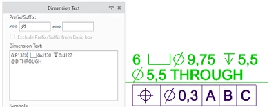

Having some issue trying to get dimension text to display as intended, I'm trying to get a custom hole note to show:
6X etc etc......
I'm using the hole &P number, but as soon as I try to put the X directly after &p132 it will not display.
I'm not sure what modifier I need to use, hopefully someone can help.
Thanks.

Because you are not using spaces, Creo is assuming some type of formatting.
Try separating the &P with brackets:
{0:&P16}X&d13 ↧&d11
@D THROUGH

Thanks, that has solved my issue. Out of interest is there a guide anywhere that details all the text edits in CREO?
