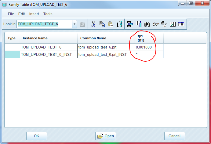

Dimension Tolerance in Family Table
How can I add, given dimension tolerance in the family table for respective dimensions.
Regards
Amit
TomUAnswer
May 27, 2014

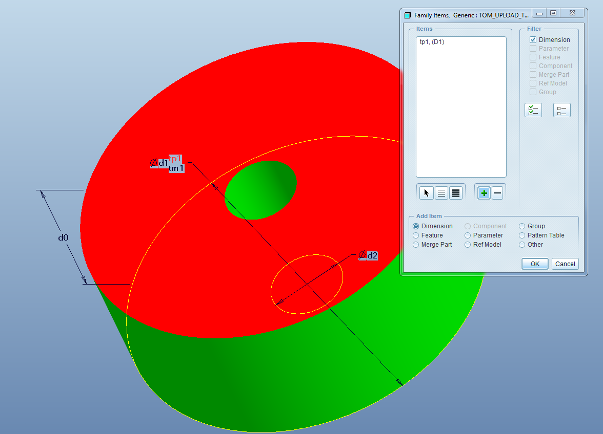

Just pick on it like any other dimension.

TomU23-Emerald IVAnswer
May 27, 2014

amitshah1-VisitorAuthor
June 2, 2014
Hi Tom,
Thanks a lot, it working for me !!
Amit
