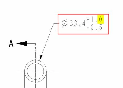

Hello All,
Can anyone help me to remove the trailing zero for the dimension tolerance (drawing config option)? Please refer to the below/attached image.
Reg,
Brijith
kdirth
October 14, 2019
This is a detail option in the drawing.
File / Prepare / Drawing Properties / Detail Options
dim_tol_lead_trail_zeros

October 15, 2019
In ASME Y14.5, you cannot remove it even if you turn off trailing zeros in your .dtl file. The + and - tolerances must have the same number of decimal places, unless one of the values is 0.
