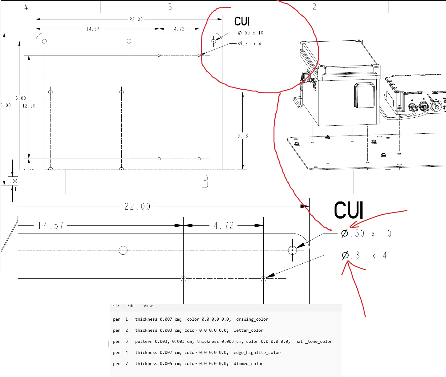

Dimensional Symbol Pen_thickness thick than all in Dwg
How to keep the symbols also consistent with other Pen_width?
SEE IMAGE Please. Thanks in advance with your solution. It looks so odd on a print.

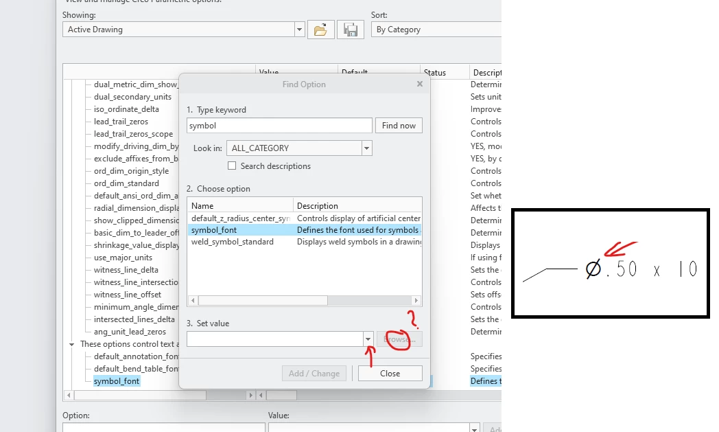

look at symbol_font detail option. It is defined in drawing and also in drawing model. In both locations it is necessary to use the same value.
Note: Test all symbol_font detail option values and set the one suitable for you.

Ohh..okay trying it now and need info on what should i browse for? i mean what file? 🙂 Image attached.
I want the symbol same as text style.
