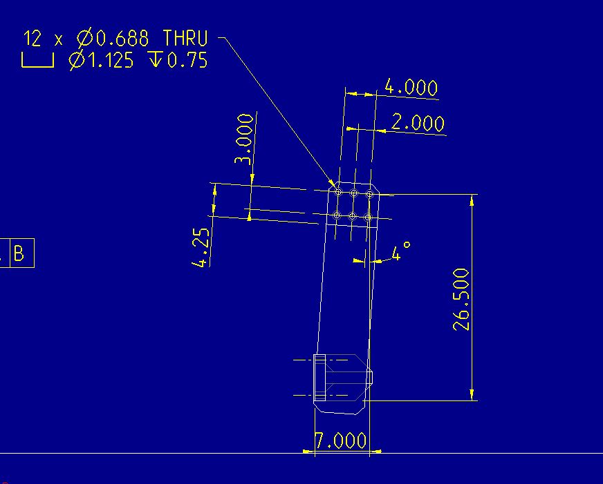

Dimensioning an angle without entity lines

How can I add another 4 degree dimension to the 26.500" dimension shown on the upper right hole of the bolt hole pattern? I was able to use the "make line" function in the new dimension function in the Annotate tab for the 4 degree dimension on the 7.000" dimension coming up vertically because you can select the vertices on the bolt hole, but they are only at the 90 and 180 degree positions of the hole. Any thoughts?
Best answer by dschenken
I can't imagine why you'd want to ...
However, you could add a datum point on the edge of the circle at any place you'd like. I think that would be as useable if the curve vertex was.
dschenken1-VisitorAnswer
