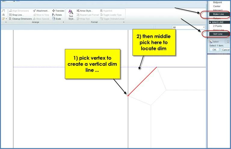

Pete Bokma,
Thank you for the suggestion. I think that what you are referring to would be A) A FAKE dimension on a drawing (if I went that way) or B) additional geometry in the model.
Please keep in mind that this draft is outbound. That may have some bearing on how it displays. Still, I would like to see a better way to display a draft dimension.

August 20, 2014
This is an option – IF I want to create dimensions. Creating dimensions is what I do – IF I cannot find any better way.

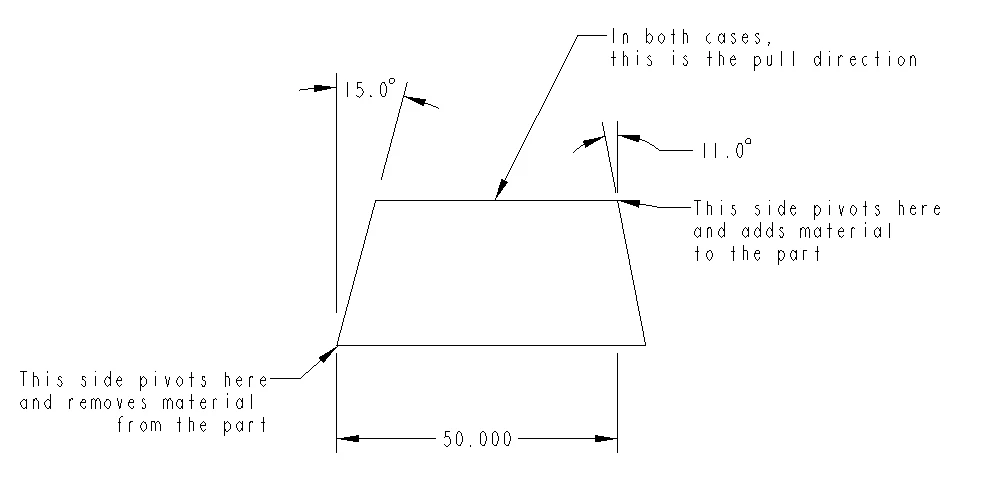

August 20, 2014
I created a new draft around all four sides as one feature, adding material to the base part.
[cid:image004.png@01CFBC7E.12E03B20]

mlocascio1-VisitorAuthor
August 20, 2014
Donald,
I selected all 4 faces around the top (or bottom) surface to draft. Then I selected the top (or bottom) surface as both hinge and pull direction.
Mike L.
