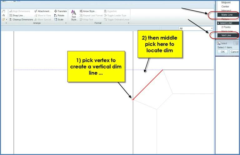

Thank you for the suggestion. I think that what you are referring to would be A) A FAKE dimension on a drawing (if I went that way) or B) additional geometry in the model.
Please keep in mind that this draft is outbound. That may have some bearing on how it displays. Still, I would like to see a better way to display a draft dimension.

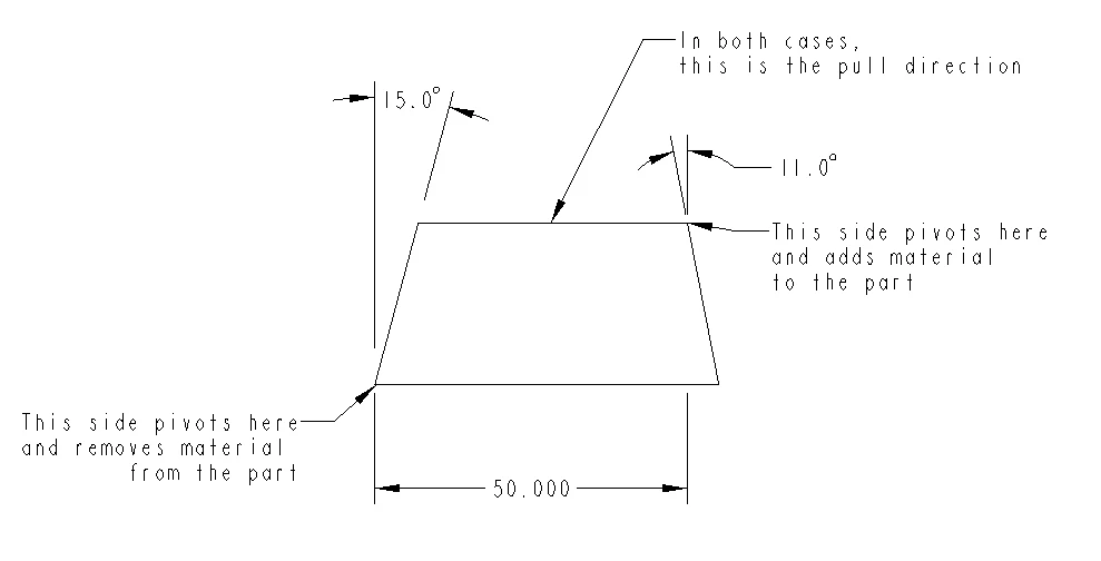

Absolutely, and it’s incredibly valuable. The hinge controls where the surface will “pivot” and the direction controls where the angle will be measured from.
I’ve created draft features where the pull direction was 89 degrees off of the hinge.

I’ve attached a small PRT file that contains all the examples I’ve shown for any users following this thread.
Edge hinge that adds material
Edge hinge that removes material
Hinge and Pull top surface
Hinge top surface, Pull bottom surface
While I don’t think I’m some kind of draft guru, let me know if I can help in any other way.

I suppose that those fake dimensions are “valid” in terms of documentation. I strongly believe in the parametric system. That means being able to work both ways. When you add a dimension, instead of showing it, there is no way to make a simple change without interrogating the model. That’s just not productive, is it?
