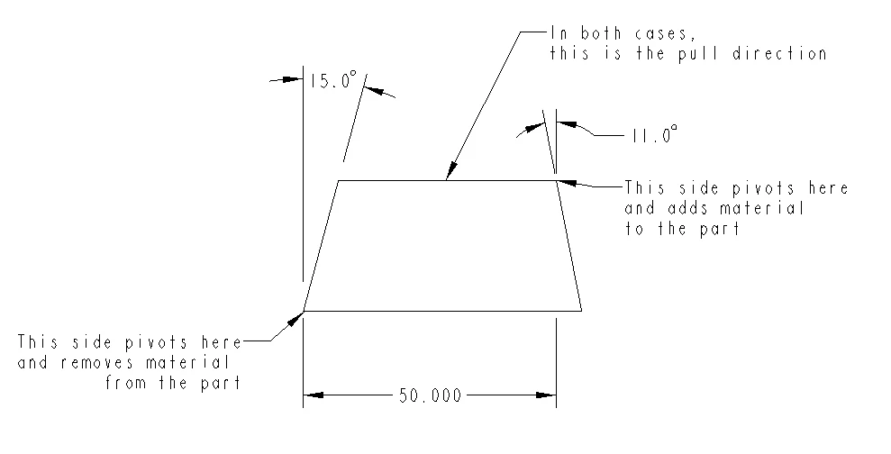

Thank you for the suggestion. I think that what you are referring to would be A) A FAKE dimension on a drawing (if I went that way) or B) additional geometry in the model.
Please keep in mind that this draft is outbound. That may have some bearing on how it displays. Still, I would like to see a better way to display a draft dimension.

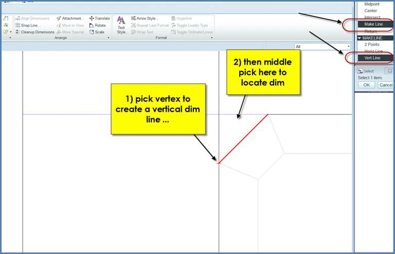

I do see a distinction between created dimensions in part annotation vs. on the drawing. In the former case the ‘fake’ dimension lives with the part/assy i.e., if the drawing file is blown away the created dimension can still be shown on a new drawing.
John
