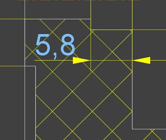

Dimensions background
Hello, I'm having a problem with the dimension background. I want the hatch background to cover the hatch. Unfortunately, this can't be set, and the hatching under the dimension is still visible. I'm working in Creo 10.

there is dtl-option def_xhatch_break_around_text
set the option to yes
to do this
go in a drawing to File > Prepare > Drawing Properties > Detail Options
or edit your dtl-file in 3rd party text editor
the active dtl-file defined by the config file option drawing_setup_file

Addition:
Also def_xhatch_break_margin_size drawing option can be set.

If the dimensions were added before you change the Drawing Properties > Detail Options; you have to manually override them: select the dimension(s), click the Format tab, then checkbox yes to the Break Hatching (under Operations group).
