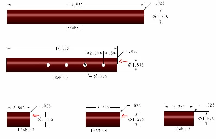

I am trying to print my Creo 2.0 drawing but the dimensions are not lining up correctly. I have tried increasing the quality as well as printing to PDF and hardcopy with all of the same results. Please see attached.
Thanks in advance!

By using CutePDF, are you generating the PDF from the .drw file?
Have you tried doing as SaveAs in Creo and choosing .pdf extension?
See if this generates the same error.

That's pretty annoying, indeed.
I took a look at a few of my PDF printouts and they don't exhibit the issue you are having.
What datecode of Creo 2.0 are on?
June 3, 2013
Thank you for your help, Antonius. I am using M040.
