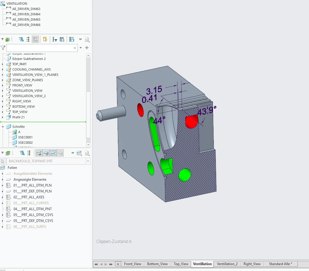

In my section view I have created driven dimesnions.

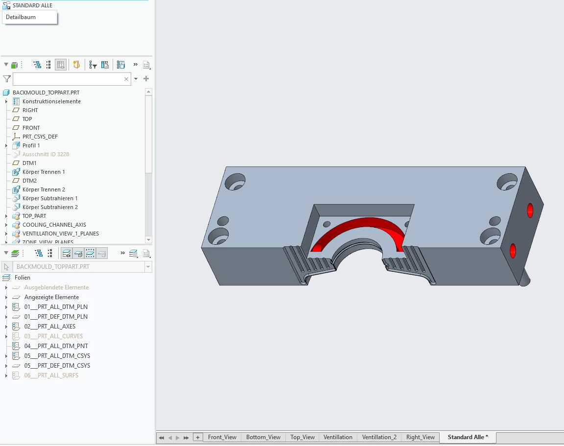

But When I switch the annotation tab at the bottom to standard view (Standard Alle) then in the drawing the dimensions dissapear.

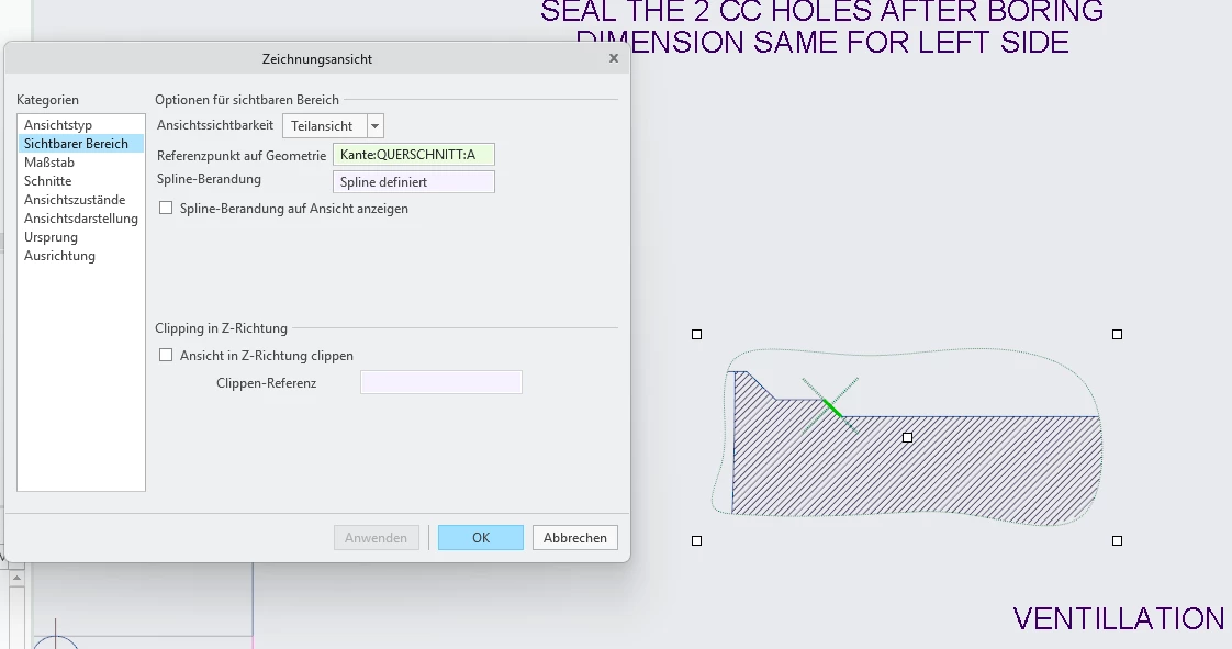

In my drawing I have applied the section and I have also applied partly visible area
How can I dsiplay the dimensions ifor a section view in my drawing?
I’m using Creo 11.0.1

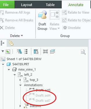

To show the dimensions in the drawing, use show model annotations.  If they don’t show, change your view from a partial view to a full view and see if they show. On occassion, partial views cause issues with displaying annotations.

You are using Combined Views. The created dimensions are in the combined view “Ventilation”. To get the dimension in the “Standard Alle” view add the dimension to the Combined view “Standard Alle”.
Save the view.
