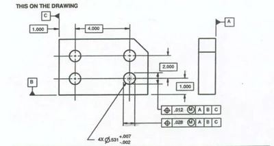

I'm looking to see if Creo (3.0) can support GD&T with a Position tolerance on a hole, representing directions of X and one for Y. With the image in this post, I'm looking to create a Size on the Hole, with two position tolerances: X and Y (or a specific direction; no diametrical zone).
This will represent a rectangular zone, rather than a diametrical zone.

I'm working in Creo 9 and would also like to know if this feature is available or if there is a work around.
