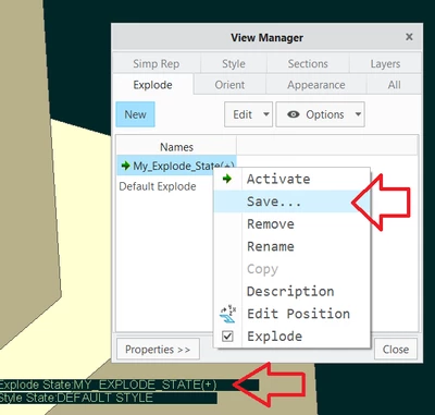

Not sure how you are doing it, but: if you have that (+) sign after the name of your exploded state... well, just know that means there are changes to it that will NOT be saved to disk upon file-save.
After editing the exploded state, the next step is typically:
I wonder how many people-years have been collectively wasted in meticulous preparation of exploded views, only to forget this vital step.  I know there are several hours of my life I will never get back 😅

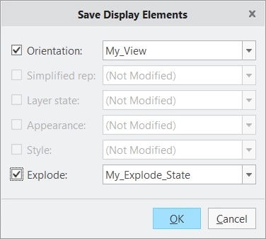

But you mention that you save the view; when doing so, are you getting a dialog box like this? :
That should make that (+) disappear, so then I'm not sure why your explode lines would be disappearing.
