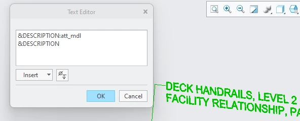

I'm currently attempting to display the "&DESCRIPTION" parameter of a subassembly within a larger assembly model, but am having issues. Here is what I've currently tried:
Typing "&DESCRIPTION" into a leader note attached to the subassembly displays the description for the overall assembly, which is not what I'm looking for.
I'm aware of some modifiers that can be added to these commands to change how they display. When I type "&DESCRIPTION:att_mdl", I get the parameter for the specific PART within said subassembly. I'm combing the list on PTC but none are jumping out as the solution (but maybe one of them is).
Is there a way to acquire this parameter for the intermediate subassembly? I can access it while searching around the parameter lists, but I don't know what command to type to display it. I have several subassemblies in this assembly and would like to show the name/description for each of them in one view.
to display Parameter of Subassembly using &DESCRIPTION:att_mdl you have to select feature which belongs to this subassembly. For example default coordinate system.
Suggestion: If you need to attach the note to specific location, create datum point in subassembly and place it to the requested location.
8-Gravel
This was ultimately the method I used to display what I wanted to display, thank you for the response. I wish Creo Parametric had functionality to perform this without having to create a datum in the subassembly; it makes it harder to place the annotation somewhere else if it has to be moved. But for now, this works as a good stop-gap.
