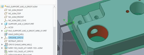

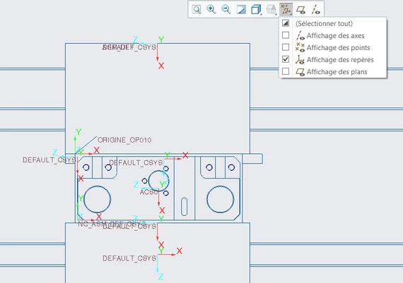

On my manufacturing plan for operators, i need to display the program origin for each operation so they can view which surface of the part they have to probe on the part.
The problem : On my plan, i can't permanently display the origin.
when I uncheck the checkbox, all disapear and i can't select my origin "origine_OP010".
Do you have some ideas ? With annotations ?

Use layers to control which csys features are displayed. Once you assign features to layers, then using show/hide layers to control what is displayed.
This should also be possible using combination states and annotations as an alternative if you prefer not to use layers.

I put the symbol on the origin. I have created a symbol called origin_nc (attached). See if that makes a difference
