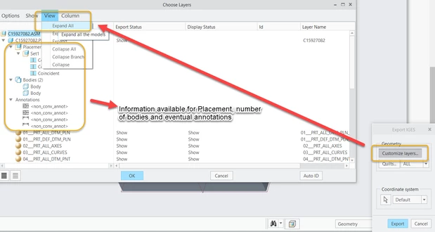

    Hello @LK_2171837
    If my understanding is correct, you speak about Customize Layer UI accessible when clcining Customize checkbox upon >File >Save as >IGES
    If you confirm this understanding:
    • We confirm change of behavior starting from Creo Parametric 7.0 where UI displays (in plus of what was offered in pre-Creo 6.0 versions) the following items
      • Placement
      • Bodies (due to interoduction of MultiBody concpet in Creo parametric 7.0)
      • Annotations
    • Proceed as follows to get the components "in line" as you would like when accessing Customize Layer in Creo parametric 7.0 +:
    • >File >Save as >Iges - give file name wished, and select Customize Export checkbox before pressing Ok (unchanged)
    • Select Customize Layers, select TOP Node, and press >View >Expand all (to reproduce the issue described in this post which is actually an enhancement to display additional information of what is about to be exported - this information was NOT available in pre-Creo 6.0 versions upon "Customize Layers" access when exporting IGES files):

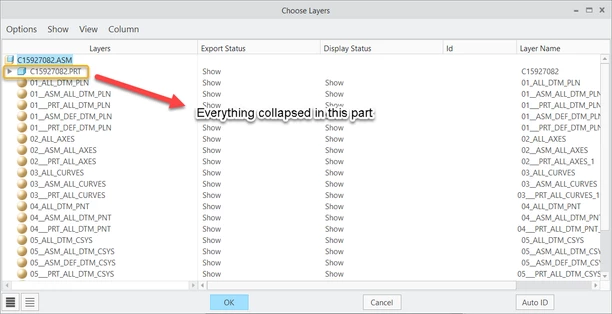

    • Select TOP Node again and just press >View >Collapse All, and then >View >Expand (!!! not Expand All !!!) to restore the level of visibility you prefer (listing ONLY Assembly and first level of children + assembly layers)
    For the eventual question you may have: Is it possible to NOT display Placement/Body and Annotation information in this Customize Layers UI in Creo parametric 7.0 + (and restore what was offered in Creo parametric 6.0-), this is not possible actually. If columns are configurable in this UI, the rows are not (contrarily to Model Tree where they are, via Tree Filters capability).

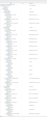

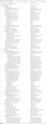

    I am working with many sub-assemblies, so having to expand every sub assembly is time consuming.
    The enhancement of additional information is a major hinderance to me. I work with many shared parts within many sub-assemblies.
    So I set levels of 20 or so parts by typing the number hitting arrow down and typing the same number. If I Expand All I now need to hit arrow down four times in between every part. Or I have to take the time to expand 30 or so sub assemblies one at a time. I can potentially miss a sub-assembly, causing issues downstream.
    Pictures below to clarify for the rest of the group. V6 to V8
