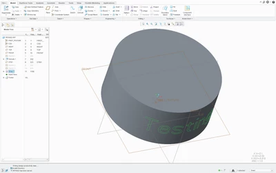

So I'm brand new to Creo and am having a hard time with some basic functions.
It seems like every time I create a sketch, it displays in green when the sketch is selected but then is hidden when not selected.  Is that normal?
I'm following a youtube video on how to wrap a sketch onto a curved surface and after I wrap the sketch, the sketch is hidden.  That part i get, since its consumed by the wrap feature.  The problem is, now the wrap feature is only visible when selected.  So when I go to project the wrapped curves, the curves are not visible.
A solution would be great, but also if someone can point me to and explanation of how working with sketches in creo should be approached, that would help me understand what is going on.

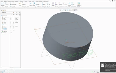

gemcoska1-VisitorAuthor
January 23, 2020

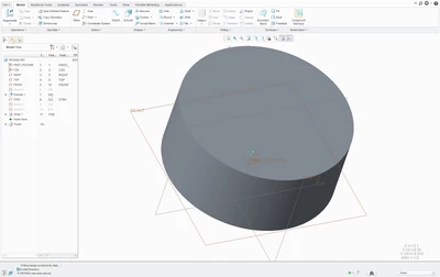

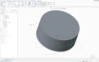

I got your response, thank you.  I followed your directions and it didn't quite fix the problems. See the below snapshots and the attached model.
Rob
Nothing on the tree selected
Sketch selected
Wrap selected
Layers - hidden objects

In your original post you should specify what version and datecode of Creo you're on.  It may be a layers issue, or it may be "hidden" in the model tree.  If it's hidden, unhide it, and save the status....otherwise it goes back to hidden when you close it.
