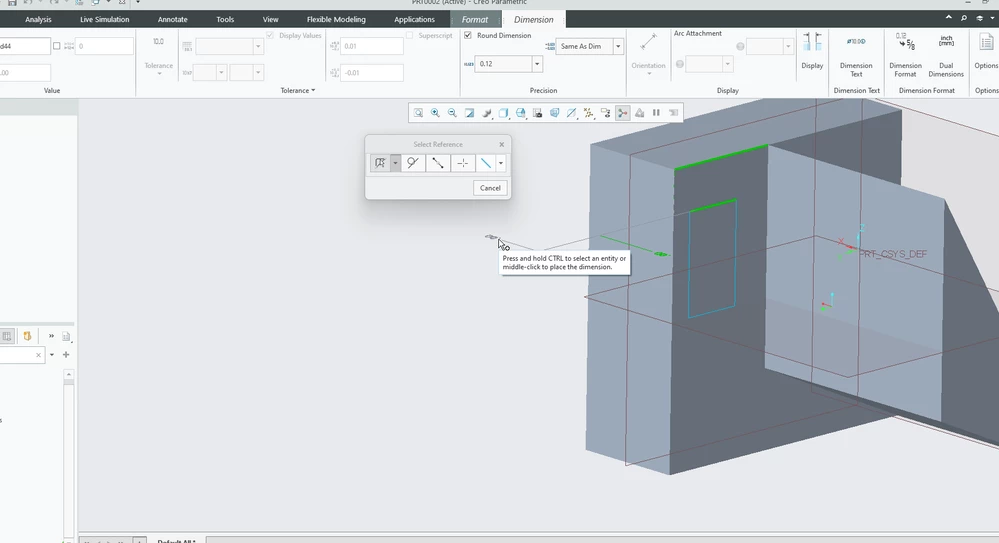

I'm currently facing a peculiar issue in Creo Parametric while working on a 3D part, and I'm hoping to get some guidance from you all.
Here's the situation: I have two parallel lines that I'm working with. One line is part of a 2D sketch, created on a specific plane. The other line exists on the original 3D body of the part. When I select both lines to measure the distance between them, it's displaying as zero, which is obviously incorrect.
I initially assumed that the line from the 3D body would automatically project onto the sketch plane, giving me the correct distance. It seems that isn't happening.

Creo is almost certainly doing what you are asking it to do.
Interpreting your screen shot:
You are not using the measure tool in the analysis tab. Terminology matters so try to use terms consistent with the PTC documentation.
You are creating a dimension (annotation ?) and your references appear to be coplanar which is generating a "zero" dimension.
