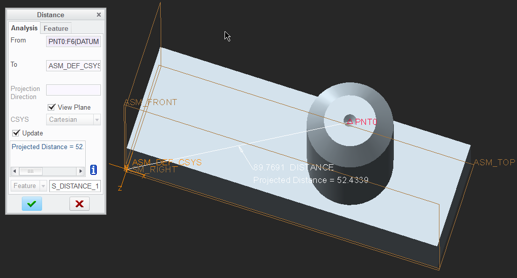

I would like to get the location of a point from a Coordinate System rather than a distance.
Is there a way to get the distance to PNT0 from ASM_DEF_CSYS in
1) the X direction?
2) the Y direction?
3) the Z direction?
Other than manually measuring each one every time I do this in a model? Even setting up an analysis feature does not give this info.
KevinAnswer
Nov 16, 2012 2:13 AM UTC
Unselect the option for View Plane and you can then specify a coordinate system as the Projection Direction reference.

Creo Parametric 2.0 measurement tool can show you the X, Y and Z coords.
Seems like you are on Creo 1.0.
nmalik1-VisitorAuthor
Nov 16, 2012 2:14 PM UTC
Yes, I should have mentioned that. I am using Creo 1.0 Parametric M020. Good to know that its available.
Kevin1-VisitorAnswer
Nov 16, 2012 2:15 PM UTC
When I un-check View Plane then the Projection Direction field becomes available and the output in the box below doesn't change.
Nov 17, 2012 5:38 PM UTC
You need to select a coordinate system for the projection reference, in your case the DEF_CSYS. You should then see the distance value, values for dx, dy, dz, the start point x, y, z locations and the end point x, y, z locations from the Projection reference coordinate system.
