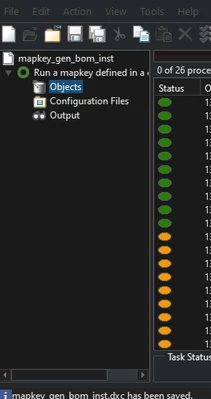

I wanted to use distributed batch to run a mapkey to generate BOM text file of an assembly.
It loads the first 10 models, keeps processing them, but never ends, and gives no error information.
My ttd. file:

It behaves in the same way, for all mapkeys, like a mapkey that only regenerates the part.
Thanks in advance for your help.

May 21, 2025 5:15 PM UTC
Hi Remy
Thanks for your feedback.
I read what you proposed. If I understood it correctly, this application isn't on the list.
There is a small success - I changed the method from mapkey to launching a trial file by makpkey. The bom file was generated, but it was empty. The performance was very low -  small test assemblies (from the family table, a few parts in each) - it took a couple of minutes to generate 10  empty files.

What am I doing wrong?
