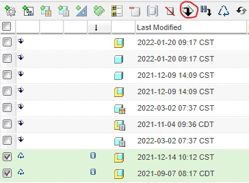

I would like Update to default to download all files, unmodified and modified.  Currently it is up to the user to change modified files to download by checking the box and selecting the download button.  I have not seen any problems with updating as long as everything gets set to download.  But, it only takes missing that step once to cause problems.
If I don't get an answer here, I will open a support case since it is not working as described.

After more digging thru articles, I finally found a setting that does what I am looking for.
The issue is on the Windchill side as I am managing the workspace from the in-session browser.
This is a change to the Windchill settings: Quick Links > My Settings > Preferences > Workgroup Manager Client > Update Overwrite Local Content  - Change to Yes
After some trial and error, I found that dm_overwrite_contents_on_update controls only the process when using Creo menus to update a file.  If using Creo menus to update does not do a very good job of warning you that the CAD data is not updating, only the meta data, if dm_overwrite_contents_on_update is set to No.
I now have both set to Yes.
