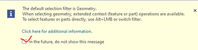

Hi Guys,
We are using Creo 7.0.2.0
When I get these little info boxes, and I check off "in the future dont show this message"
How can i save this so all the other users dont see these messages? Is this saved in the ribbon file?
We have about 30 seats of creo, and we all currently pull our files from the same central place on the network.
This makes it easier for me to update menu ribbons, mapkeys, etc etc.
But these pop up info boxes are annoying everyone. LOL.
Is there maybe even a place to just turn off ALL these info boxes all at once?
Jay

They are stored in the creo_parametric_customization.ui file.  It is possible to copy one of these to an admin file and place it in the loadpoint (where Creo is installed).  Take a look at these pages:
https://support.ptc.com/help/creo/creo_pma/r8.0/usascii/#page/fundamentals%2Ffundamentals%2Ffund_three_sub%2Fabout_saving_ui_custom_settings.html
https://www.ptc.com/en/support/article/CS37185
https://www.ptc.com/en/support/article/CS288341
