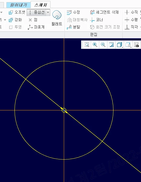

DOT line style appears as a straight line on the screen
All dot lines (center line, axis, dotted line, etc.) appear as solid lines.
I reinstalled and overwritten the config file and setup file with the existing ones.
Before re-installation, it appeared as a dotted line properly.

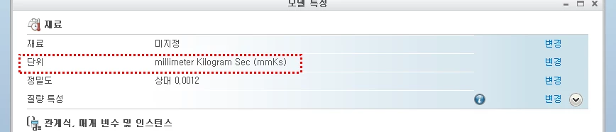

Seems to occur in 3D Mode as per your snapshot ('Part and Sketcher environment). May this be due to Units configured - eventually different from the units you have the habit to work on?
  • This can be checked under >File >Prepare >Model Properties >Uints

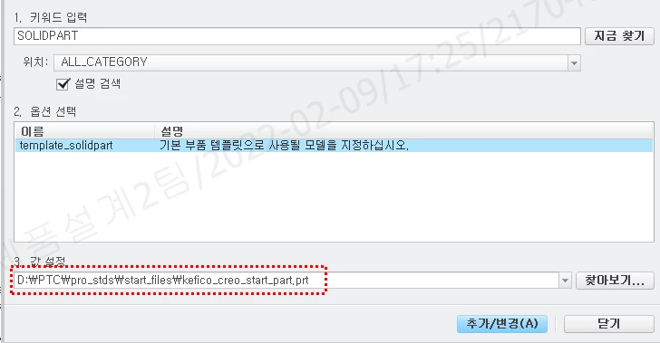

  • If units are different than the usual ones, and if this occurs fo new parts, the object where template_solidpart points to is maybe improperly reconfigured or missing?

Thanks for answer.
The unit is using a normal mmKs unit.

And also the path and file of template_solidpart are not missing either.
