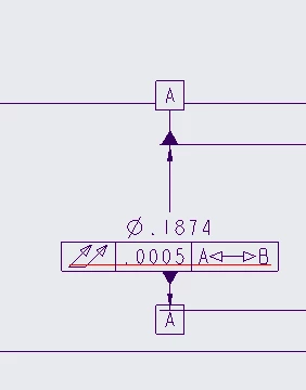

Hello everyone,
Are any of you getting and issue where you attach a datum to a dim and CREO (drawing) creates TWO of the same datum feature symbols? This is the first drawing I have encountered this problem with. Not sure what's going on, but I can't seem to delete one of them because it deletes both datum feature symbols.
add the shown option to the dtl file and update the drawing sheet:
