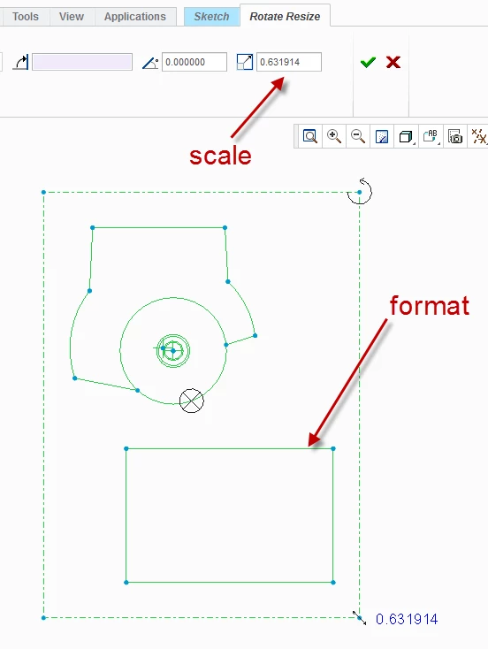

I was just playing around with this again to see where I went wrong with the scale.
By default it came in at less than 1 to 1. Changeing the number in the scale box to 1 fixes the problem.
I had to delete the format lines.
[cid:image001.png@01CF7E40.A327E060]
