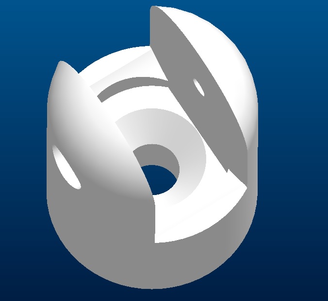

I am familiar with parting lines and pull directions for molded or cast parts, but I have not had a lot of experience designing parts with draft. I have an initial concept of a part shown in the pictures. My two thoughts for the parting line would be either the top of the cylinder near the four tabs or where the slot at the bottom of the part intersects the cylinder. There is some geometry in the bottom of the slot shown in the second picture.
Besides the parting line question, I am also wondering about the order of operation. Typically rounds/radii go towards the end of the part. What about draft? Do you get a concept done similar to what I have and then add draft, or is it added up stream. This is a fairly simple part, so if it needs to be upstream, I can easily recreate the part if needed.

This is a common question for many working with molded parts.
The simple one to answer is the drafts and chamfers. Add them after drafts. All too often a feature will fail from an arbitrary round before draft.
As to parting line, this is usually driven by the design intent. With some license... I would consider the flat face on the 1st image to be the logical parting line providing flash at the assumed mating interface, in this case. Also remember to logically direction of pull for the center bore which I would probably keep with the countersink feature.
Only a few design intents would change my perspective. If the cylinder and 4 tabs were a critical mating feature, and a fillet or chamfer on that edge was desired or even critical. I would be aware that flash at the transition would be clearly visible, or would require post mold operation.
As to when to apply the draft; rarely do people think draft while modeling and they spend a lot of time after the fact to apply it. I don't know if the "dome" is sculpted or a simple round, but features like this can really slow you down when adding draft. I will do both but I like to work on primary features with draft already defined. Some things just don't lend themselves to doing this simply so those I might feature straight, consider the tooling, and add drafts at that point (before I am too committed with more dependent feature).

The main cylinder with the dome was a revolve. I went back and added angle to the outer edge of the revolve to get "draft" for the cylinder.
The center pocket so far I was able to use the draft tool. (Actually I tried this after not getting the outside to draft - when it worked, I realized that the draft function probably did not like the transition from the cylinder to the dome.)

I had rounds/fillets on the part when doing the intial concept, but blew them away on a copy when starting to add draft.
