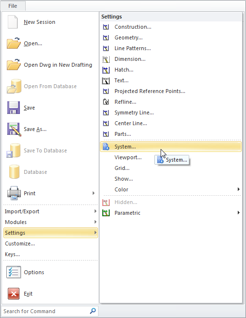

First there is no need to export the drawing out of Annotator to be able to open it up in Drafting (ME10), Annotator saves to the same format as Drafting does (.mi).
If you save the drawing in Annotator correctly as an .mi file then load it into drafting the scale should be the same as it was in Annotator 2:1 in visual scale and the dimensions should still read or created as 1:1.

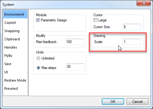

If you wanted to increase or decrease the overall size of the drawing then you need to go into File Tab | Settings | System
And then in the System settings menu change the Drawing Scale as required.
Thom

"And then in the System settings menu change the Drawing Scale as required."
As far as I understand, this affects not just all the parts in the project, but all the system with all the .mi files...
So, can I reduce the system scale with the part loaded, save it, bring back the system scale 1:1, load the part again? I think, no... am I right? (can not check it until Monday).
