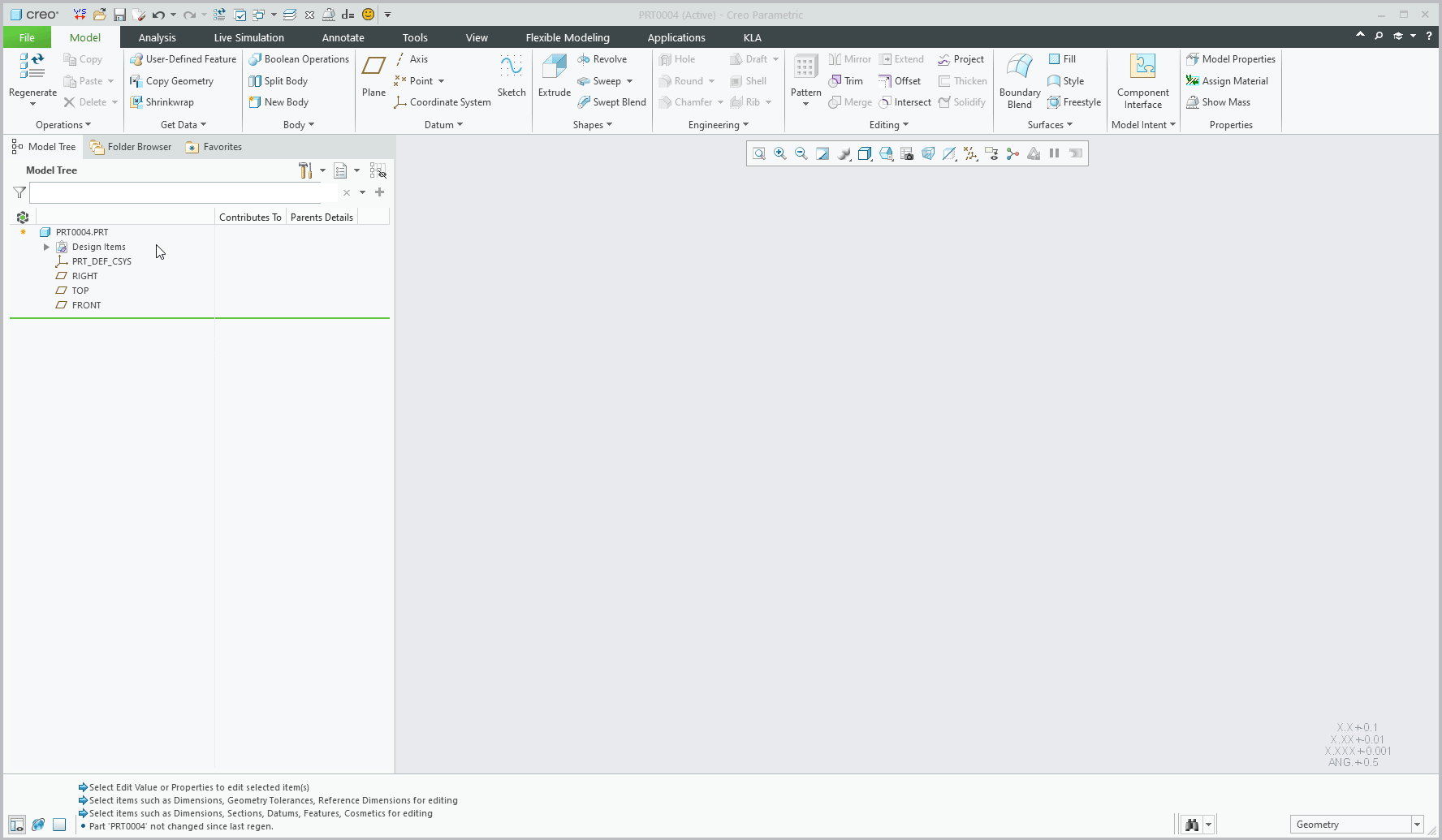

How do I drag dimensions while in edit mode like this:
https://www.youtube.com/watch?v=kRxBD-B5IrY&t=49s
I attached a gif of me trying to drag sketch dimensions.
it doesn't matter if dimensions are weak, strong or locked.
I'm currently using Creo 8.
thanks

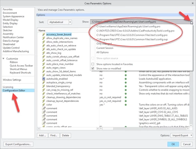

Sep 17, 2024 11:19 AM UTC
Maybe a bug, more likely a setting.
Try temporarily removing all config files. I typically just rename them with an X in front, but you can do it however.
Then restart Creo and retest. This will give you and "out of the box" test with no options set.
You can find all your config.pro files under file options configurations editor.

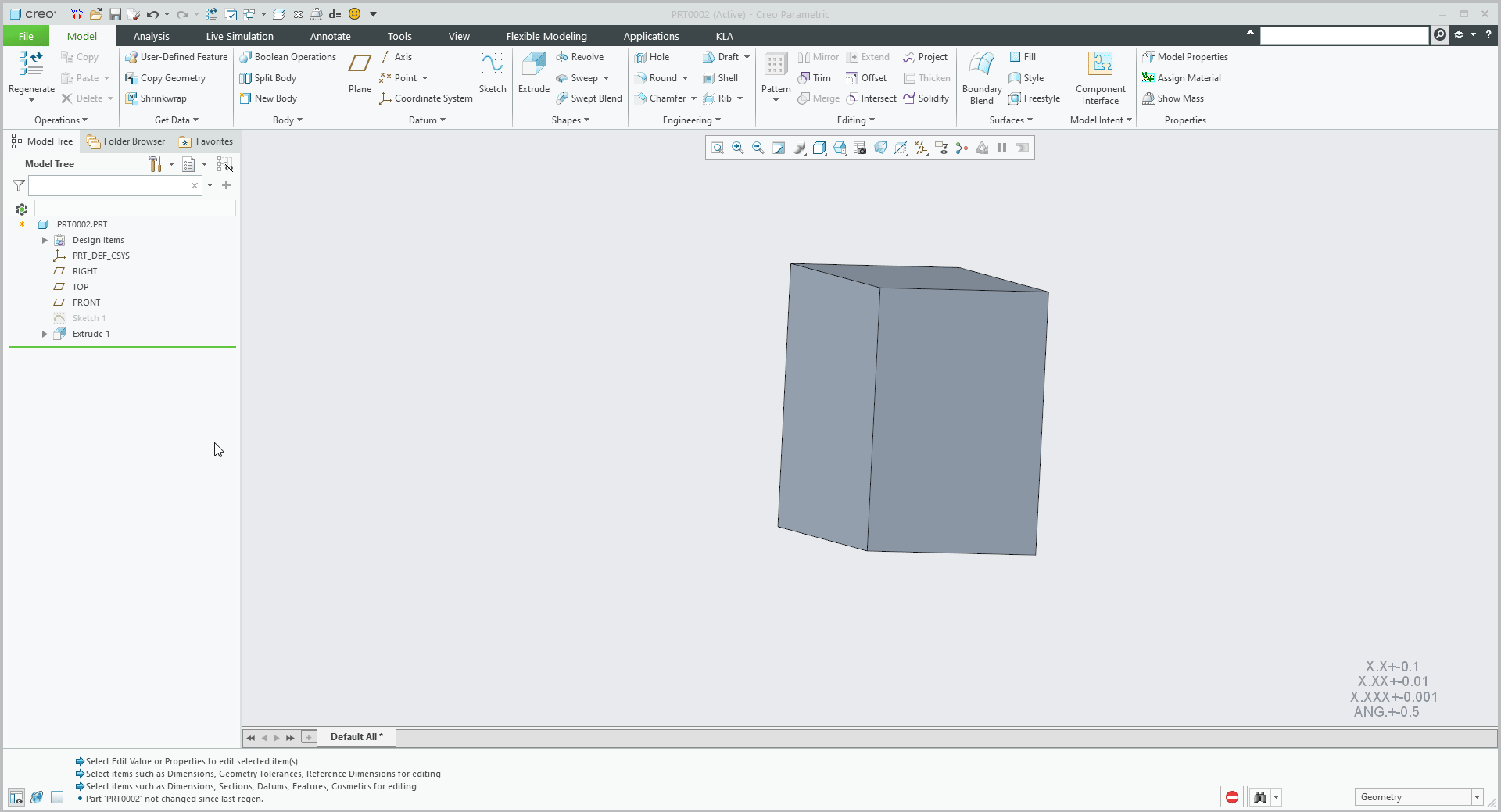

Sep 16, 2024 2:03 PM UTC
the dimensions are not locked.
look at the new gif i attached.
I remember being able to do it when i worked with creo back in 2019...
did they change something?

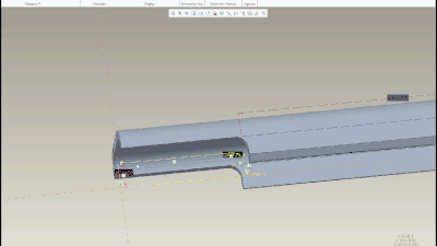

Sep 16, 2024 1:50 PM UTC
They are dragging a dim of a sketch of the feature shown being flexed viewed in 3D. You can activate the sketch (modify dims) via the model tree to access the drag handles and dimensions while in a 3D view. Activate the sketch to show the dims and you can then LMB to select the sketch elements and drag.
@StephenW has noted that if the dims are locked in the sketch, then you would not be able to drag them. It looks like he has identified the issue you are having.
See this video.

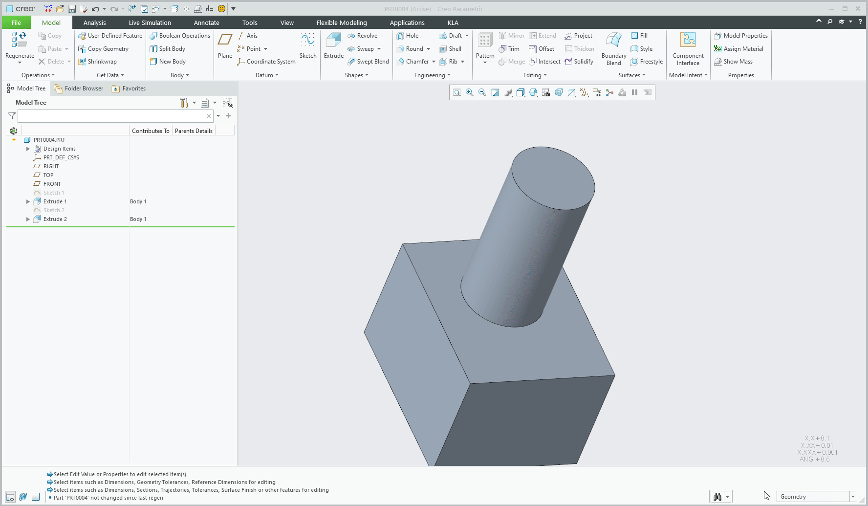

Sep 16, 2024 2:04 PM UTC
this is exactly what i am trying to do .
but i cant grab the dimensions.
i attached another gif
