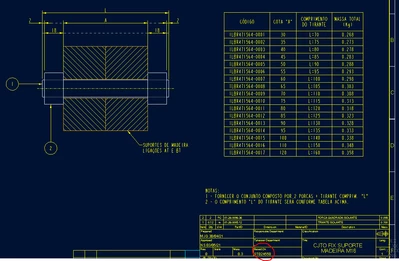

Create an assembly, which has a family table where it varies the length of a tie.
This tie is in flexible because it is used in other assemblies.
The question is, I created a drawing for the generic assembly and whenever I open the other items on the family table, I cannot link the drawing of the assembly with the models on the family table.
Below the drawing created for the generic assembly.

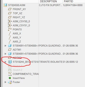

And this is the error that appears when I try to open the drawing of the generic assembly by a model of the family table.

I just needed to finish with the doubt, follow.
Is it possible for me to link this model of the family table to open the drawing of the generic assembly?
