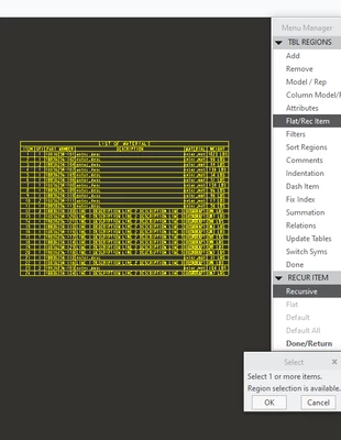

Go to the table table, then repeat region icon, then in the menu manager that pops up, hit Flat/Rec item and pick the table.

When I import step files, I usually get an extra level. So to generate a BOM on a drawing, I would need to either add the model to the drawing that has the structure as I want to see it or  set the bom item(s) in the table as recursive so it goes down to the level I need.

I do remember the recursive trick from some training but for the life of me I cannot find it. It was nested in a dropdown I remember.
