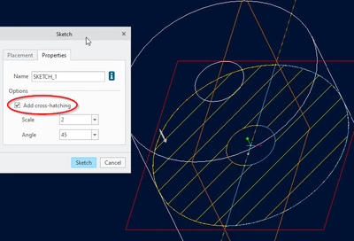

In a part, I created a sketch and cross-hatched it.  You can change the cross-hatch scale and angle.

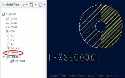

In a drawing, I can't control its hatch spacing or angle.  I can't pick it at all.
Goal: In a section view, I want to turn off the section's cross hatching and substitute my own.  My sketch is intentionally drawn NOT to match the true section through the solid geometry.  To get it to look right, I need to be able to adjust MY sketch's spacing and angle.
See screen shots and attached files.  "Sketch 1" is the cross-hatched sketch.  In the drawing, how do it get to have different line spacing and angle?

The sketch cross-hatch has to be modified in the model.  The width of the cross hatch in a sketch is relative to the size of the sketch.
See: http://support.ptc.com/help/archive/creo40/creo_pma/usascii/part_modeling/sketcher/To_Add_Hatch_Lines.html#
When placing the view on a drawing, what you see in the model is what you get in the drawing.  However, the view of sketch cross-hatch in the drawing does not appear to update when the sketch cross-hatch is modified in the model.  I would consider this a bug in the program.  The only way to update it, as of CP4.0 M130, is to replace the view.

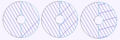

Here is an image of the same view created three times changing the sketch cross-hatch between placing each one:

For CP4 M040, changing the hatch scale then replacing the drawing view worked.
In the part, I set the scale to "10".  When I added the new drawing view, the hatch spacing looked good enough that I didn't have keep iterating back and forth.
