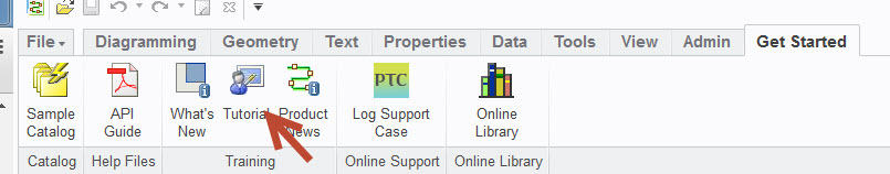

Hello Chuck,
Regarding your first issue (drawing arc)
  • If you didn't done it yet, i recommend you to practice Creo Schematics tutorial (in Get started tab->Training->Tutorial)
  • Creo Schematics include very helpful help center, just search for arc and the first topic will be 'To Create Arcs'. when you need help on some issue - I recommend you to start in the Help Center, there is high probability you will find answer/example there. (File menu->Help->Help Center)
  • In general - all edit line tools require to be in edit line mode which can be done by :
    - during draw of line :Click Line and select a line tool->Click a start point on the sheet -> use the edit line tools
    - double left-click on the line will enter into edit line mode -> use the edit line tools

April 29, 2014
Chuck
On page 42 of the tutorial that is available from the get started tab 29-04-2014 16-11-47.jpgthere is all the steps on how to create a new port shape from scratch.
From page 47 a block from scratch - on page 49 step 28 it will tell you how to edit a line.
From Page 51 a variable group from scratch.
After completing these exercises you should have all the basic information on how to create to catalog items, so I am afraid I do not understand you comment about how to recreate everything that already exists and no details on how to make them from scratch.
Re the central catalog have you read the help topic Working with Central Catalog. In this topic it states After an item has been incorporated into the Central Catalog it is locked automatically and only an editor can edit it. The administrator sets a password for the design that the editor uses to unlock for editing. So what this is saying is the design needs to have a password, which will allow you to unlock the catalog and make changes.
On page 32 of the tutorial there is step by step instructions on how to create a drawing template and how to import existing design sheet templates / logos.
