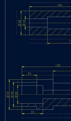

Hey everybody,
fighting with Creo Parametric on a weekly basis within our classrooms i'm slowly getting better with Creo8.
I'll take a try within this community basis: is there a config.pro-option (or elsewhere) to adjust the automatic length of the centerline within a half-section-view. "half-section-line" within "Drawing properties" does change the appearence (from solid to centerline and vice versa), but the offset length (and the adjustment) is a mystery. Where can i find the correct option within gazillion Creo-possibilities?
Looking forward 😉
Edit: yes, i tried to handle/modify it directly...

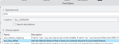

Try axis_line_offset in drawing DTL - File > Prepare > Drawing Properties > Options [change]

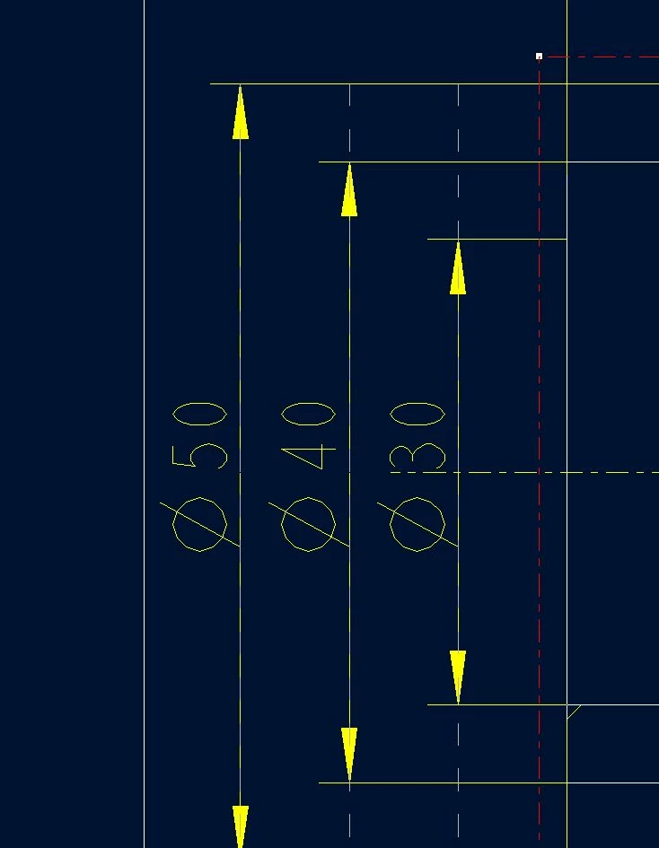

Unfortunately not; "axis-line-offset" defines the offset of model-axis. Since the shown axis is generated by the section-dialog its not affected by that option.
Top part axis trimmed by axis_line_offset, bottom part is not affected at all.
