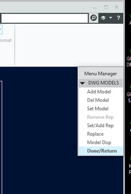

I am using Creo 9.0.5.0. When I replace models in a drawing, the drawing models menu manager is "hiding" behind the drawing instead of remaining on top of the drawing so I have to tab to it in order to be able to click on "Done/Return". Anyone else experiencing this? I moved it to the right, but after closing and reopening, it back to the same spot.

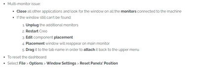

Hello Dale,
Can you please try this, Article - CS218107.

Not sure what I need to try. The window is found, it is just hiding behind the drawing window and won't let me execute a command until I find it and "Done/Return" it.
Oct 12, 2023 2:00 PM UTC
  • Rename .wf folder located at C:\Users\<username>\AppData\Roaming\PTC\ProENGINEER\Wildfire
  • Select File > Options > Window Settings > Reset Panels' Position
