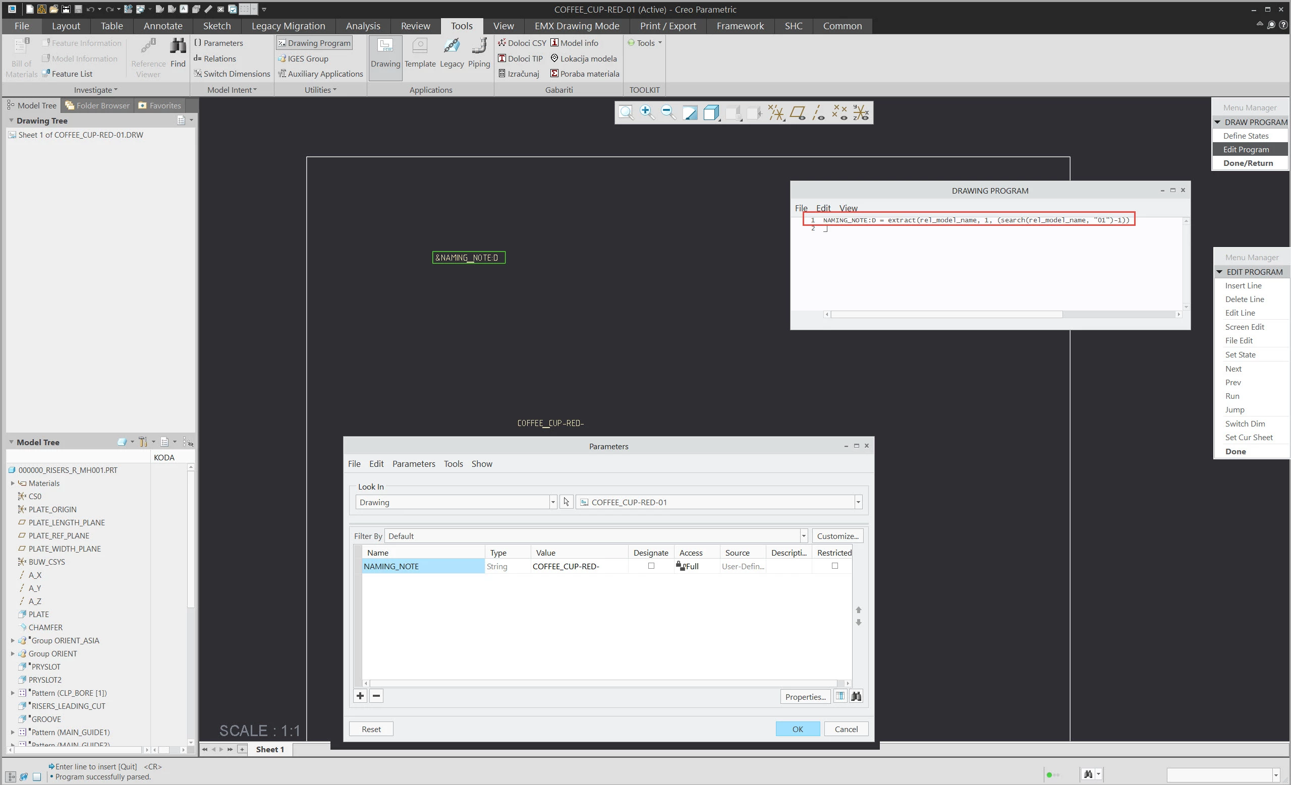

Just add this line to drawing program:
NAMING_NOTE: D = extract(rel_model_name, 1, (search(rel_model_name, "01")-1))
This will create drawing parameter NAMING_NOTE with drawing name.
Then add a note with &NAMING_NOTE.
Example in the attached picture.

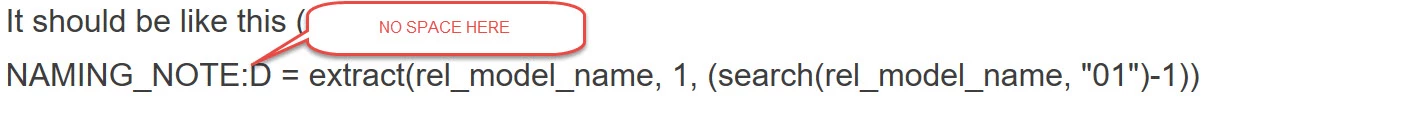

Parameter rel_model_name used in drawing proprogram refers to the name of the drawing - it is the same as the &dwg_name used in notes/tables.
It gives an error because there is a space between ":" and "D".
It should be like this (picture attached):
NAMING_NOTE:D = extract(rel_model_name, 1, (search(rel_model_name, "01")-1))
