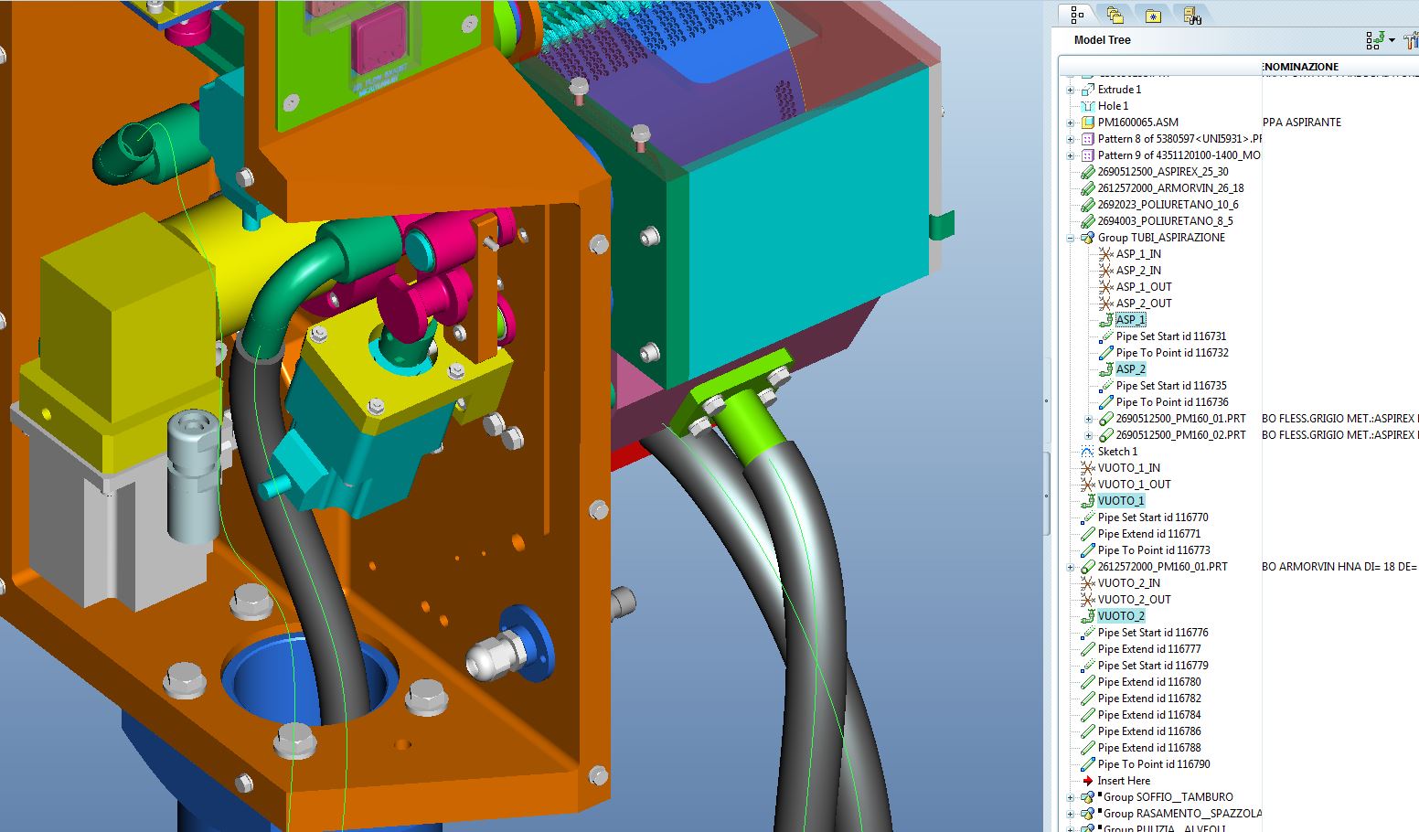

Hi all,
my goal is having a second BOM Table into the drawing. The first as the standard, where we have the component; the second with the features Pipeline of the Piping Module.
I know that I could make solid pipe, but within windchill, is difficult manage solid pipe.
See another post of me.

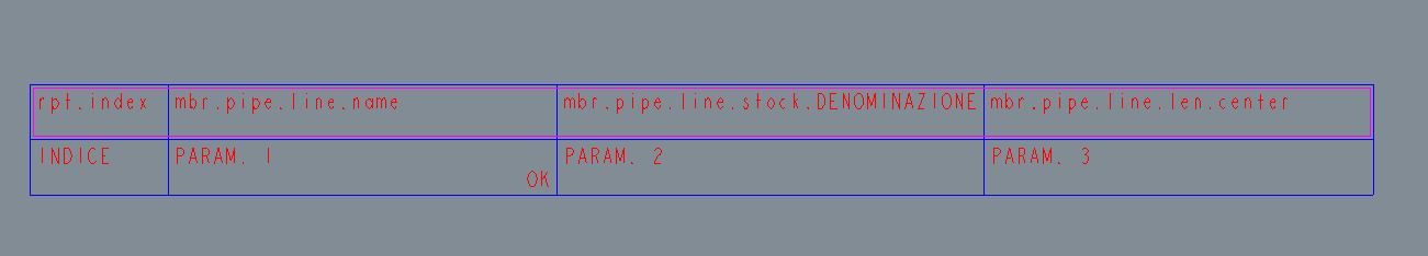

I create the table with the index, the name, the name of the stock, the length.
Now the problem is that I'm not able to place the baloon in the drawing.
I attach a very simple example made in WF5.
