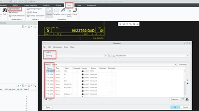

Drawing Parameter :d broken
I used to enter &model_name:d into the title block.  We just upgraded to CREO 10.  I tried adding the parameter to the drawing even.

Does &model_name without the ":d" work?

according to https://support.ptc.com/help/creo/creo_pma/r10.0/usascii/index.html#page/detail/System_Parameters_for_Drawings.html document model_name is drawing system parameter. This means that the 😄 suffix does not need to be specified.

To get the filename of the current active part or assembly in a drawing, use &model_name
To get the filename of the drawing in the drawing, use &dwg_name
The (:d) option is valid for drawing parameters, not system parameters
