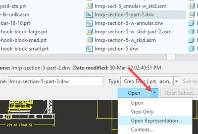

StephenW
Mar 30, 2022 8:16 PM UTC
Forgot to mention, you can directly open a drawing rep from the file open dialog to avoid having to open the full drawing.
Select the drawing, then hit the drop down arrow in by Open to get to the Open Representation and it will let you pick which drawing rep you want to open initially.
