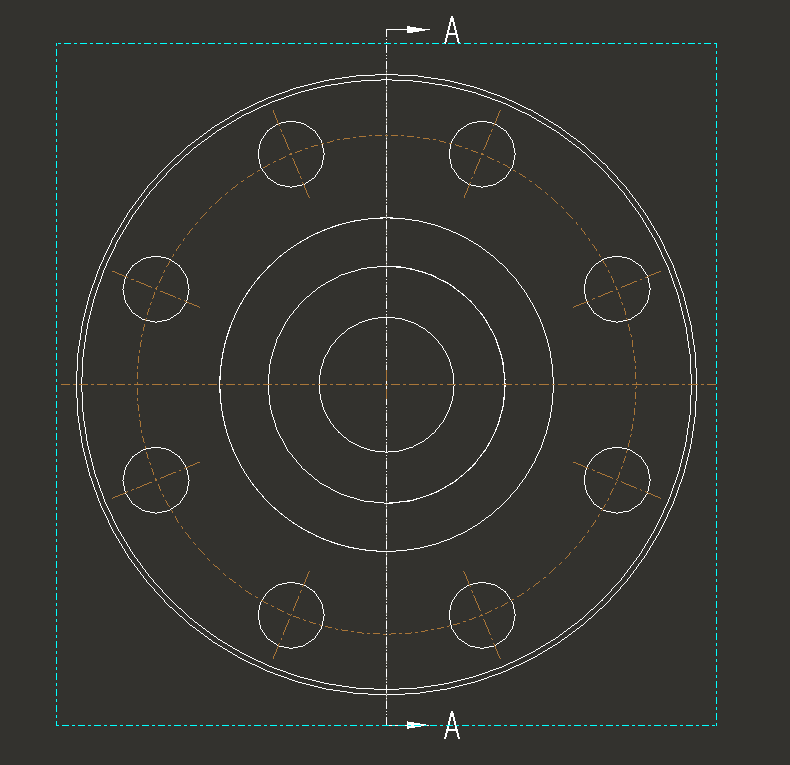

New to Creo 3.0 coming most recently from NX 8.5 (fun learning curve so far!).
After a bunch of fumbling, I got my drawing to show the bolt-hole pattern with the dashed line, but I cannot get the diameter to display in the drawing for the pattern.
I made the first hole as a diameter placement, used a pattern with the degrees/qty, and have the radial_axis_pattern_circle activated.
Any help would be appreciated, thanks!

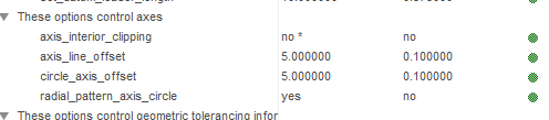

Hi, I don't understand why this wouldn't work other than the syntax of the variable is wrong. Should be radial_pattern_axis_circle set to yes.Capture-table.PNG

Just to be sure, you are wanting the axis to show something like this, correct?
Creating your first holes as diameter is correct provided that is the dimensioning scheme you are after.
I apologize again for mis-speaking, the option is only a drawing setup option, not a config.pro option.
Drawing setup option is in the drawing under file - prepare - detail options change
radial_pattern_axis_circle YES
I'm not sure why yours isn't working.
I created the initial hole as a diameter type specifying bolt circle diameter and angle from datum.
I created the pattern using AXIS instead of dimension pattern but I tested the dimension pattern and it worked too.

Appear to have got it! When clocking show model annotations and clicking in the general area of the part, I was not selecting the entire view but some subset (datum perhaps?) thus it was giving me far less options for dimensions to show.
