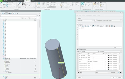

I tested it once again and managed to do exactly what you want, its suprisingly pretty easy
1, Create relation for length of your profile IN PART not in assembly
2, In the table put in &asm.mbr.delka in new collum (or you can combine everything in first collum like [&asm.mbr.ptc_common_name - &asm.mbr.delka]
3, profit

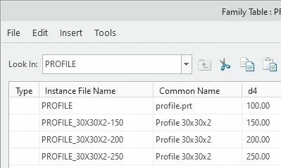

I don't believe this is possible.  Flexibility does not change the part/subassembly file.
What you need to use is Family Table.  This creates one part with many versions.
kdirth
Here is an example part with family table for the 3 example variations.

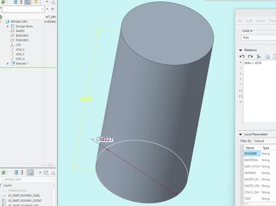

Van_AG
In the family table of profile.prt add a variable parameter (for example, ptc_common_name as the profile name) and a variable dimension (for example, d4 as the profile length).
See pic1.

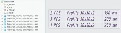

In the drawing
Create a 1 row/3 column table.
Create a repeat region with type "Simple" for all three cells.
Set attribute "No Duplicates" for the repeat region.
Type in cells
1st: &rpt.qty PCS
2nd: &asm.mbr.ptc_common_name
3rd: &asm.mbr.d4 mm
See pic2 (symbol "&" not displayed but exist in cells).

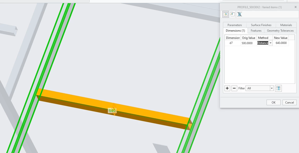

Why I'm using flexibility?
Example:
I want orange profile to have the same length as distance between green profiles.
I don't need to measure anything, just click 2 surfaces and it's done.
For family table and relations i need to create a lot of instances or a lot of relations. I want to avoid it.
I want to use the same instance many times and change just lengths.
So I'll ask again, does anyone has idea how to show this "flexible" length in table on the drawing?
