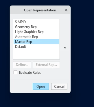

Hello, I have created a drawing template with bom tables pre-set so when I create the drawing, everything is already in place. The issue is, I want it to read a specific simp rep on creation. And right now it seems that "Master" is the only option?

When creating drawing after choosing format there is popup window to choose which representation you want to create drawing from.

Thanks for your reply, however that popup your showing happens after you select a "format".
Now create a drawing and select "template", if you get the same result then I'd like to know how.
Jul 14, 2025 5:40 AM UTC
You are right that doesnt happen when selecting from default template. Sadly, I dont see any config option so I guess its creo bug.
