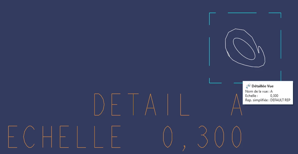

In order to make the tooltip of a view appear (white window in the image below), I need to stay still on the view for approx. 2s, can I make it faster ? Or alternately delete the waiting time ?
Thank you in advance.

I find the delay most rather ambiguous - sometimes it's instant and sometimes delayed. No obvious pattern really.
I looked for config options that could be related to this, but found none that seemed really spot on. Maybe you could try POPUP_MENU_DELAY ? It's a hidden one so there's no official description for it.
https://www.creosite.com/cgi-bin/find_option.cgi?srch=POPUP_MENU_DELAY&ver=creo7&mode=config

Thank you for your response, indeed the delay seems random.
I will wait for CREO to make a stable version of this option, as using a hidden one could be risky.
