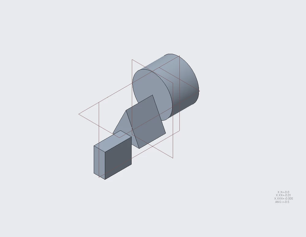

Hi, this is a simple concept but hard to explain.
How can I create a drawing view where the background is clipped away?
Here's a visual example...
If I have this model...

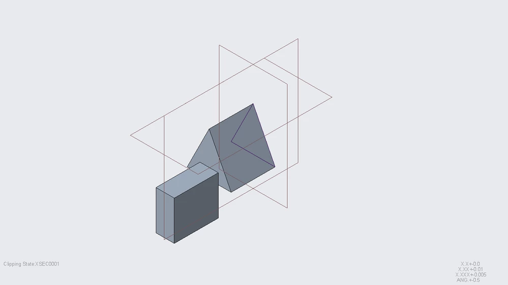

And I create a section view using the front round surface, cutting out the disk.

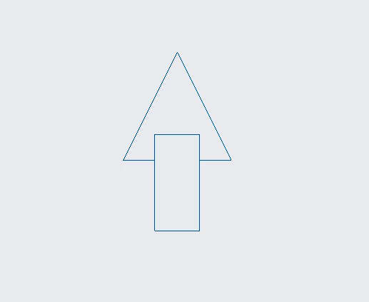

How to get a drawing view, where I am looking at the part from the front so I can see the rectangle and triangle but not the disk?

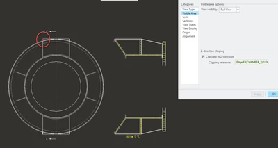

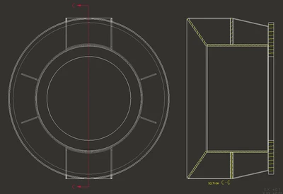

Something is a little off. My assembly i am working on below with just a simple planar section. Not the best example but maybe it will help. it doesn't matter whether its a section or not, works the same, everything behind the clipping reference point it simply gone.
1st image is with no z-clipping
2nd image is with an arbitrary point (behind the cross section cut) that shows that everything behind that point is clipped. The z-clip is easiest to pick in another view. I circled the z-clip reference point I selected

In the view properties dialog box, select the Visible Area tab, then use Z-direction clipping. You will specify the point at which creo hides everything behind.
