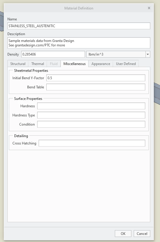

I'm guessing you can do what I'm about to ask, but I just can't get it to work.
I want to automatically show the cross hatch defined in the material definition in a section view on a drawing. I would think this should be pretty simple to do.
I define the cross hatch for the material by entering the name of the cross hatch under Misc./Detailing/Cross Hatch of the material definition. See .PNG below. I want to use a Hatch PAT not a Hatch XCH.
However, when I create the section view in a drawing the hatching that is displayed is the random hatching that Creo assigns to it.
What I'm I not doing? Any help would be great.
Thanks, Steve

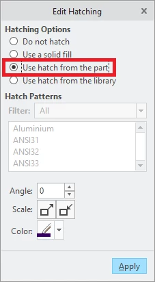

you have to do Edit Hatching and set Use hatch from the part option manually. According to https://www.ptc.com/en/support/article/CS148466 it is not possible to set this option as default.
