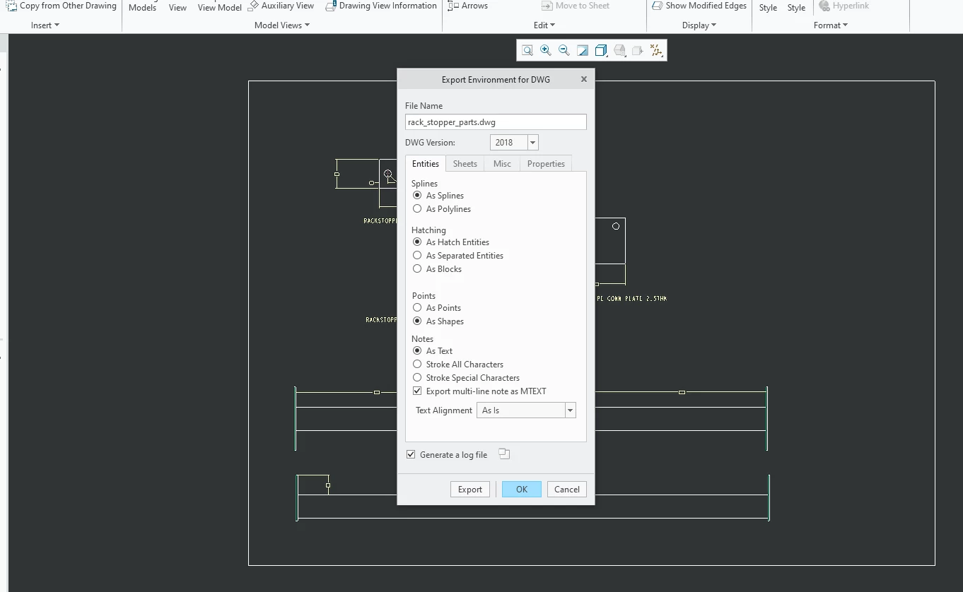

While exporting an drw into an dwg file...if i open that file in 2d softwares after export,the scale was not as same as it was in CREO DRW !
what should i need to do while exporting to get the exact scale value in both ?

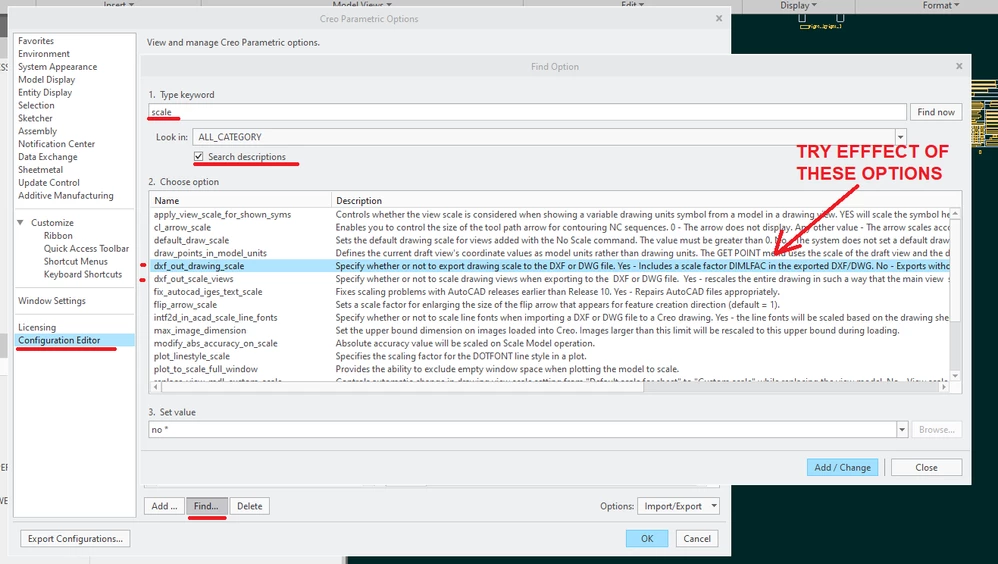

Not sure, but perhaps you can try modifying your system configuration:
