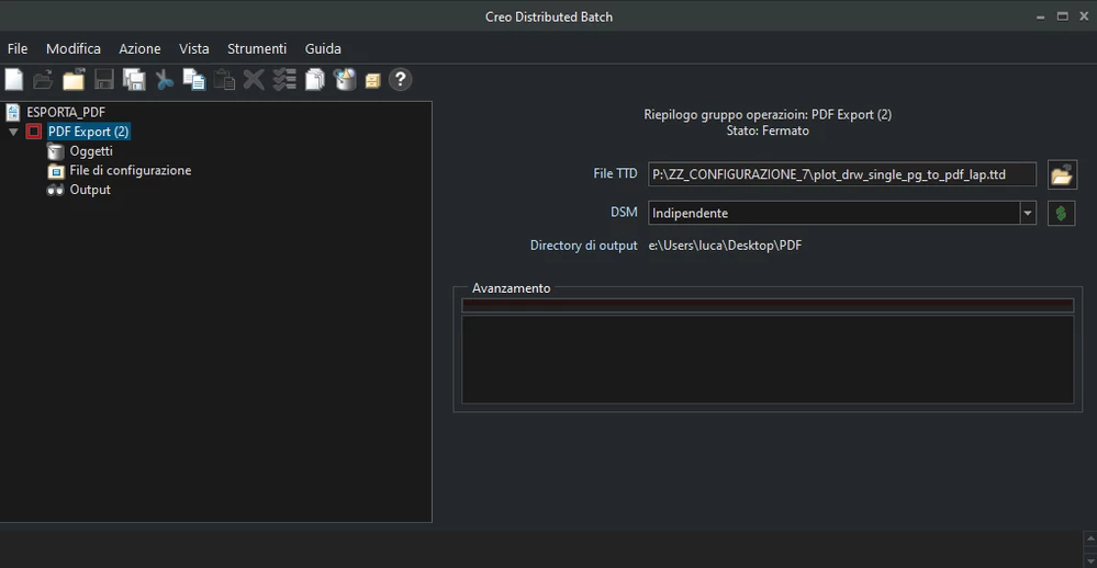

hi,
i fix my problems by setting the creo distributed batch like this:
i copied the plot_drw_single_pg_to_pdf.ttd in my config directory, changing its name.to plot_drw_single_pg_to_pdf_lap.ttd
and i modify some things.
Like getting monochrome print instead of colors
<color enum="PRO_PDF_CD_MONO"/>
or cad fonts instead of true type for example
<font enum="PRO_PDF_STROKE_ALL_FONTS"/>
exporting all sheets instead of a single one
<sheets enum="PRINT_ALL_SHEETS"/>
(in the end of post the complete ttd xml file)

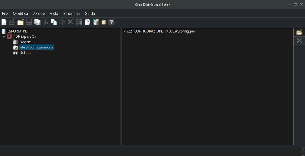

then i create a distributed batch pointing to that file
dsm indemendent
in the configuration file i added just my config.pro that have inside all information about colors plotter and pen table.
it works. some time i have to run the task and manually select the objects, right click and send them again.

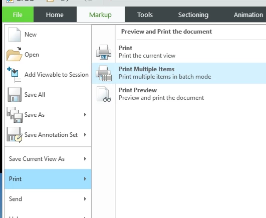

Sep 16, 2026 9:55 AM UTC
The simplest way I can visualize is to open the files in Creo-View and print using “Print Multiple Items”.

Sep 16, 2026 10:28 AM UTC
First, the original inquiry was on creating PDF files from drawings, not printing.
Second, I’d imagine, like Creo, Creo View has a limit on the number of files one can open at the same time. If a person wishes to process 100s of files to produce PDFs, They’d have to open up the most they can, process them, close all of them, then open the next set, etc. Not fun, guaranteed to result in missed files.
Thus, some sort of batch operation is needed, which has been discussed in many threads over the years, with a variety of approaches presented.
Sep 16, 2026 10:43 AM UTC
I use Creo View Lite. I open the drawings in Creo View Lite and Print to PDF. One can have a mix of different paper sizes too. One need to set the Paper sizes before the print command. The print processes in a sequence and hence, the chance of miss is less. Having said this, it is definitely not a one click print.
As for the number of files that can be opened, my list has never crossed 25 or perhaps 30. So, I am not aware of the limit on the number of files that can be opened in one session of Creo View Lite.
The process pauses for the name of file to be entered at the time of printing. It is pretty straight forward once one gets a hang of it.
